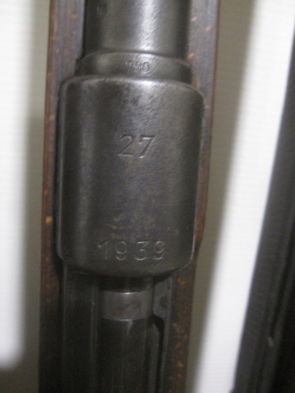

1939
ERFURTER MASCHINENFABRIK (ERMA)
![98K : marquages de boitier Img_2653](https://i.servimg.com/u/f18/13/09/56/46/img_2653.jpg)
