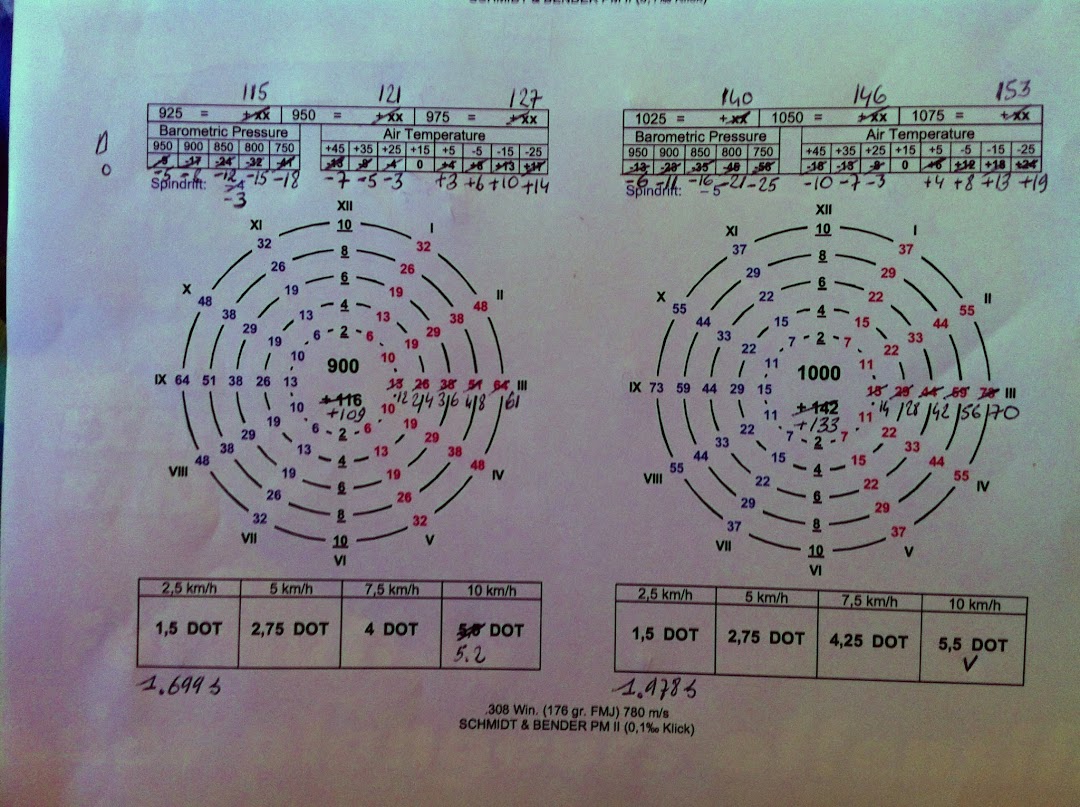

Les tables papier restent indispensables:
![Nouveau logiciel de balistique Web%2520Albums%2520App%2520Upload%2520-%252006.08.12%252018%253A57%253A05](https://lh4.googleusercontent.com/-HKdotAIyEmo/UB_3a8lJjZI/AAAAAAAALTQ/xDvzYQYjLJ0/s1080/Web%2520Albums%2520App%2520Upload%2520-%252006.08.12%252018%253A57%253A05.jpg)
Table balistique en élaboration
