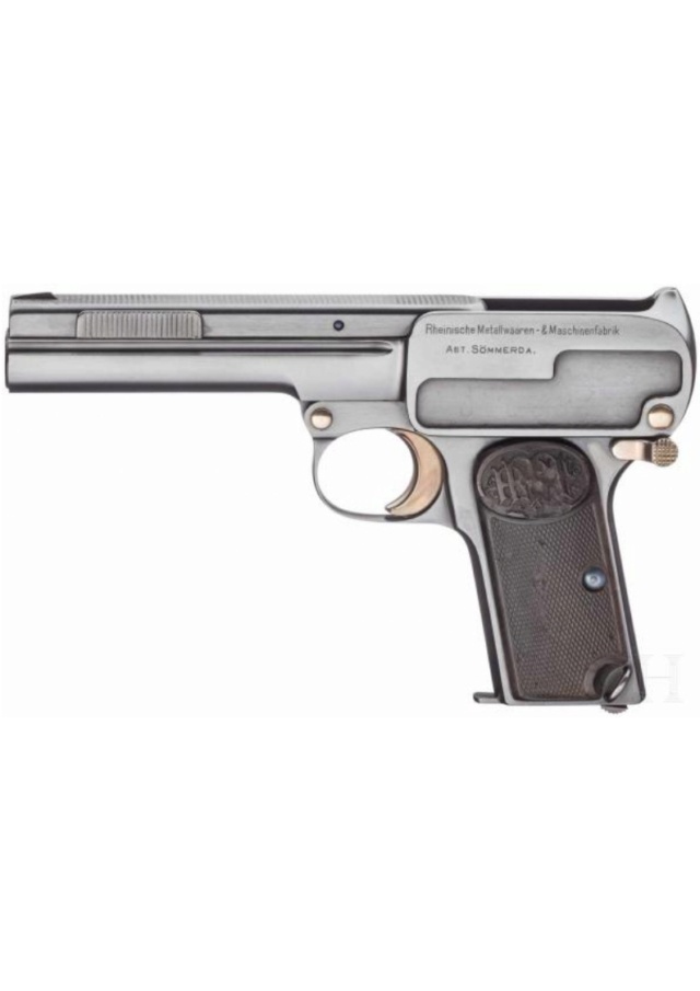

* Dreyse 1915
Prototype Simson 1929 9mm Parabellum Soffic11
